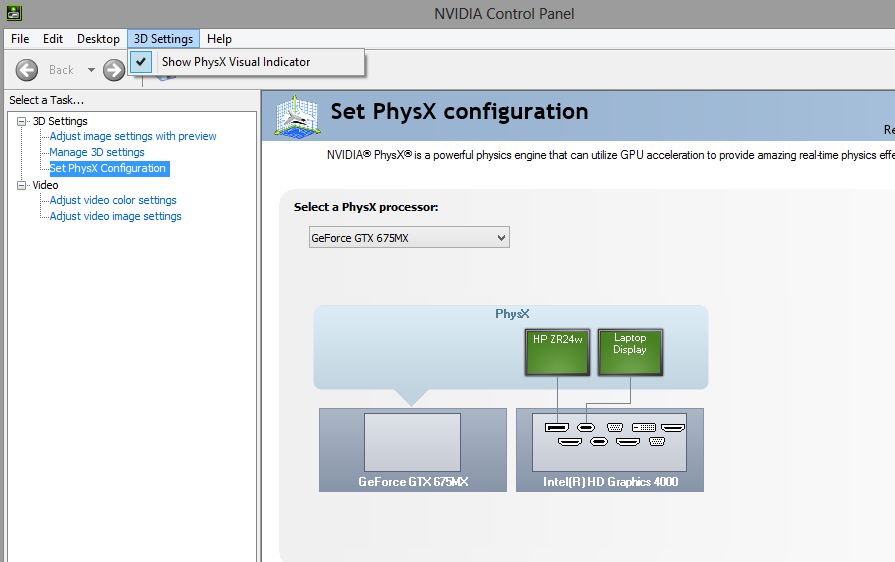

I realized why I had it checked, and it wasn't because of render rate stats, but present stats. With "don't use linear light for dithering" checked and the video full screen my present rates are in the 3ms area, but with it unchecked and the video full screen they are in the 11ms area.
Edit: Windowed Full Screen (D3D11) runs with the 11ms presents, but if I run in D3D11 Exclusive (10 bit) its back down to 3ms again. Edit #2: Unchecking "present a frame for every VSync" also seems to be a way to bring it back down to 3ms while in (D3D11) Windowed Full Screen mode.
System specs: Sager NP9150 SE with i7-3630QM 2.40GHz, 16 GB RAM, 64-bit Windows 10 Pro, NVidia GTX 680M/Intel 4000 HD optimus dual GPU system. Video viewed on LG notebook screen and LG 3D passive TV.

Originally Posted by 6ari8 View Post
Are you using an HDMI port? I think you can probably bring down the present stats to below 1ms by using the DisplayPort (though that depends on the laptop). You can see which port you have that's connected to the discreet GPU from Nvidia's control panel. Mine has the mDP only but there are different cases for laptops like these:
Yes, I have an HDMI port that I connect my TV to, but both the TV and the laptop screen are shown to go through the Intel GPU like the second image you posted. Here is the PhysX display diagram on my system:

Old 13th July 2015, 06:23   #31715  |  Link
6ari8
Join Date: Jun 2012
Posts: 43
Mine's like the second one. Yours seems to be like the third image.
Unfortunately, that means that all your output ports are connected to the Intel GPU.
I don't know what gaming laptop makers were thinking by choosing to connect output ports to the iGPU. I think anyone using their laptop to drive monitors with those ports would be using a power supply so connecting them to the discreet GPU would've been a much better choice.
With your setup, I think you should use exclusive mode with either D3D9 or D3D11 because that brings down the present stats to around 1-3ms for me when I'm using my HDMI port. Windowed mode gives me 8-9ms present.
