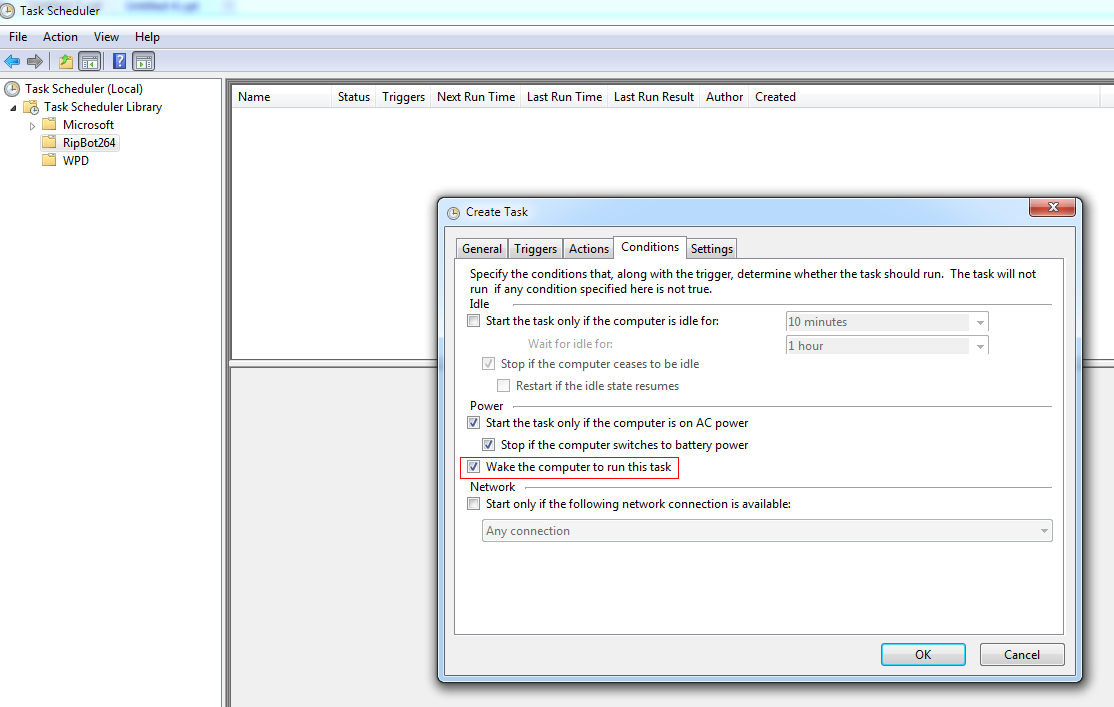

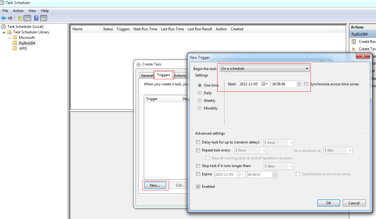

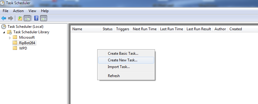

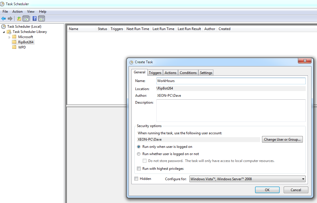

Can you check if WAKE function even works on your PC?
Try this
1) open Task Scheduler
2) create new task
3) Type WorkHours as name
4) Click triggers tap -> new -> specify time
5) Actions -> start program -> rundll32.exe
6) Conditions -> Wake the computer ...
Now suspend your PC.
