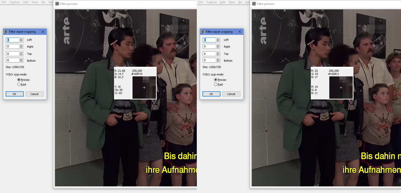

Old 11th November 2023, 17:41   #1213  |  Link
shekh
Join Date: Mar 2015
Posts: 775

https://i.postimg.cc/P5gGLqrG/image.png
In VD2 you can use shift+mouse move within filter preview to inspect pixel values.
The random difference per component is related with the codec being lossy. But overall (if you average any large portion of the frame) it should stay the same, works for me. Used x264 at crf 20 in this example.
VirtualDub2
shekh is offline   Reply With Quote

Originally Posted by nji View Post
BTW: If do a VD2 encode to HuffYUV it's OK with YUV12, but brighter in RGB mode.
Moreover for me personally it's anything but expected that
encoding an avc1/709/YUV421 movie losslessly as HuffYUV
does fine as YUV, but as RGB changes brightness.
Originally Posted by shekh View Post
All of this can be involed in some scenarios, but when you look at the picture in VD2 it is already converted to rgb for display (same YUV-RGB conversion is used either for display, filtering or encoding). And this rgb should not be affected by anything after you send it to rgb codec, except the codec accuracy.
Yes, the preview is an RGB converted representation
For RGB codec, lossless codec like lagarith should be "accurate"...
And when you save out a YUV export directly, there isn't necessarily a RGB step if you do it properly - and there was a claim that lagarith YV12 was also incorrect:
Moreover I tried: input AVC1/ Rec709 and output Lagarith (Both with RGB and YUV12 format): Both results are slightly too bright.
Try with AviDemux: Read the above video, write with the lossless codecs... all fine.
This one needs more clarification . Did vdub2 use RGB filters > Did avidemux use the same RGB filters? Because avidemux suffers the same +/- 3 8bit YUV=> 8bit RGB=> 8bit YUV issue because it's simple math and unavoidable with 8bit RGB
If no filters, then lagarith was not used correctly . There should be no colorspace conversion if you set video=>fast recompress . So YV12 in should be YV12 out, lossless. Also, lagarith in RGB(default) mode does not actually convert to RGB, it retains the input colorspace - if you send YV12, RGB(default) actually uses YV12 too - also lossless. But if you send RGB, then RGB(default) uses RGB. So this might be some other issue like a preview issue (eg. your viewing program might be using Rec601 to convert to display for the lagarith YV12 version, but 709 for the MP4 version. But you would expect the same problem with avidemux lossless codecs on playback...)
For the RGB lagarith version, I can see no other explanation than a rec601/709 mismatch - it's converted incorrectly
But if "slightly too bright" refers to the max +/- 25-30 then the Rec601/709 mismatch, is the most common explanation. Either conversion, or playback chain incorrect
For me it's different (BTW x264 @ crf18):
The RGB version is slightly lighter - almost everywhere.
(Checked by frame exports and subtracts).
If it would have been a random pattern I wouldn't get suspicious.
nji is offline   Reply With Quote
Old 11th November 2023, 20:43   #1217  |  Link
shekh
Join Date: Mar 2015
Posts: 775
This is weird. Describe 'frame exports'?

OK, I did a "round-up" test for the topic.
For that I used these programs:
VirtualDub2-32 (newest)
MPC-HC-64 (1.9.23, Aug. 22, not newest)
AviDemux-64 (newest)
IrfanView-32 (newest)
PaintShopPro-32 (7.x, stone age)
1st scenario:
Open the movie (see above) with VD2, MPC, ADM respectively
export the first frame as png.
Result (as of IV and PSP):
VD2 > MPC > ADM (">": significant overall brighter, i.e. not randomly).
The difference is so significant that I would have different manipulation
parameters when working with VD2.
PROBLEM_No1.
2nd scenario:
Open the movie with VD2
write it as h264/ crf18/ RGB.
Now take this result movie and do the same test as in the first scenario.
Result:
All exported RGB frames are (about) the same brightness. (Hurray!)
And their brightness is identical to the original of... of...
VD2.
(This doesn't contradict to my posts above ("RGB is brighter"),
as there I exported the orig frame by MPC (= darker)).
My conclusion of all this:
It seems (!) like MPC, and ADM even more, have bugs of showing/ writing
contents too dark.
Maybe someone checks my results and conclusion?
Last edited by nji; 12th November 2023 at 12:36. Reason: MPC/ AD flaw also in writing.
