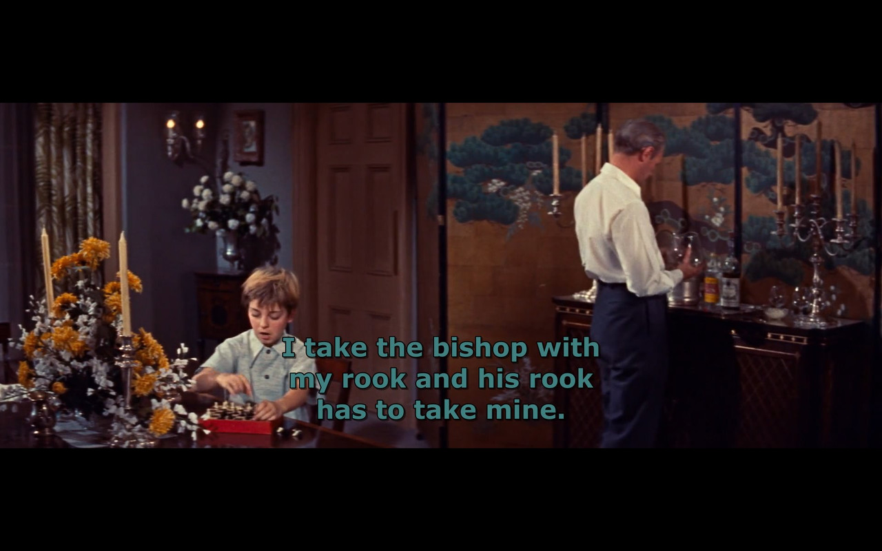

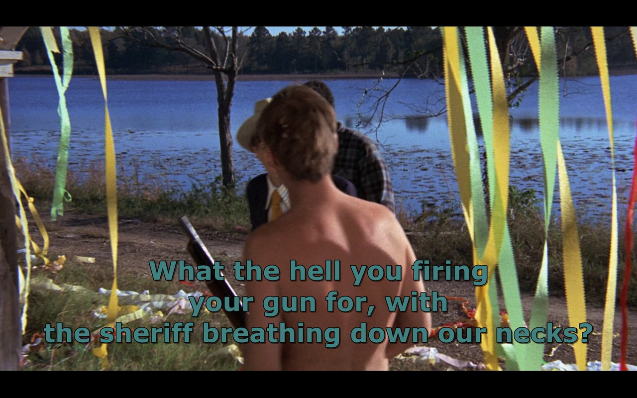

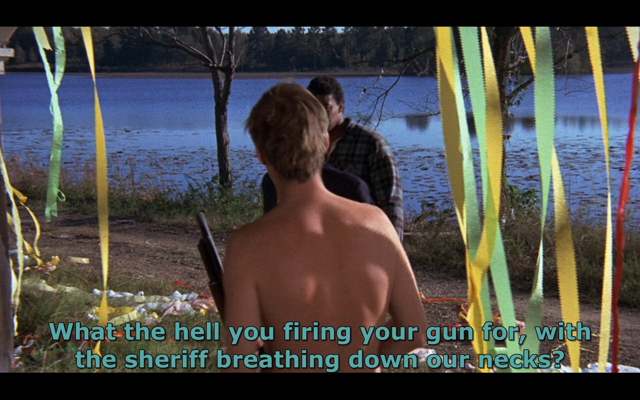

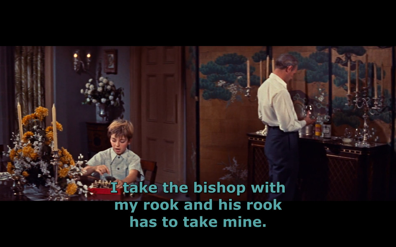

For example, if I watch a 2.35:1 movie using MPC-HC:
https://i.postimg.cc/qBF3cZtP/X1.jpg
And the same scene using MPC-BE:
https://i.postimg.cc/P5WvjX6H/X2.jpg
Everything is wrong for MPC-BE. Subtitle position and size based on what kind of video is being asked to display.
MPC-HC for 1.85:1
https://i.postimg.cc/jStPCnn2/X39.jpg
MPC-BE for 1.85:1
https://i.postimg.cc/SR9CYWG2/X40.jpg
Perenista is offline   Reply With Quote

Upload sample video with subs and show MPC-HC settings for subs ?
