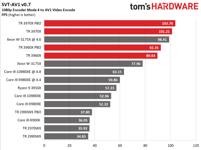

Ryzen 3950X is very fast on SVT-AV1, no doubt about it, it's even faster than latest HEDT from Intel Core i9-10980XE which has 2 more cores, BUT Threadripper's devastating performance is simply out of this world.
It's three times faster than previous Threadripper 32C and two times faster than latest Intel 18C

100 fps using -enc-mode 4?
HAHA, no. Not even close

I'm actually more shocked to see a performance graph that actually uses an FPS metric than anything. I got frustrated and stopped looking at such charts because they always had useless, or obscure metrics that involve extra math to find out what the performance is; and that's on top of them not even telling you the encode settings or other critical information
Someone should ask Toms what the hell "1080p encoder mode 4 to AV1 encode" even means and if they speak english.

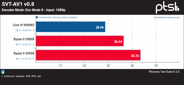

Posts: 2,901
Running Linux, tested by Phoronix.
https://i.postimg.cc/nL6c7W9H/svt-av1-39xx-9900.png
