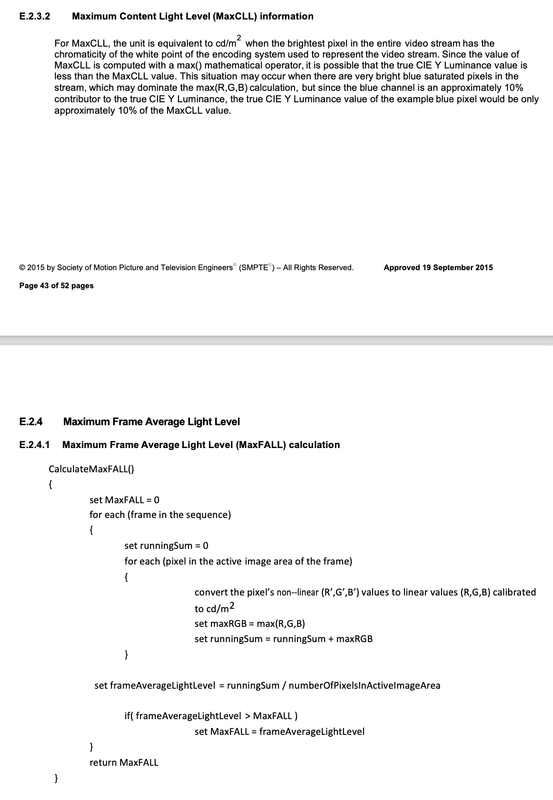

Question: Is it a safe assumption that the brightest pixel is always white?
EDIT: I'm asking because pqstat just told me that Aquaman clocks in with a MaxCLL of 3,190, yet the metadata puts it at 1,506. I've never seen that kind of disparity before.

This is exactly what can happen with compression overshoots. You get very misleading results.
MaxCLL quite often come form the top of the production chain, where people work with EXRs or TIFF, so those should be more accurate than ones calculated form h265 compressed files.
I would still blindly not rely on MaxCLL.
There should be free EBU etc. doc about calculating MaxCLL.
There is this:
http://avisynth.nl/index.php/MaxCLLFind
Some paper:
None of it mentions low pass filtering, but this also (quietly I think ) assumes that measurements are done on uncompressed assets.

2nd page is for MaxFALL (in case this is confusing).
this ZIP has random info regarding HDR:
https://spaces.hightail.com/space/nEaXy

So MaxCLL really is assumed to be white, and furthermore, no single color channel for any pixel can exceed what it would be to produce white at that brightness...
If that's how this really works, I'm going to completely redo tonemapping in pq2hlg. I won't have everyone waste their time with running the whole thing through pqstat. I'll just have them feed MaxCLL into pq2hlg instead.
-- EDIT --
Where on GOD'S GREEN EARTH is MaxCLL formally defined?! It's not a part of BT.2100, BT.2408, or BT.2390. It's also not a part of ST.2086. Is it a part of the HDR10 specification? Because I can't find that, either! All I can find is that it (HDR10) is controlled by the CTA.
What SMPTE publication is that above? Or is MaxCLL a part of that document dump?
Last edited by wswartzendruber; 11th March 2021 at 06:22. Reason: Haplessly searching for MaxCLL's formal definition.
No idea. Grabs are from SMPTE document.

I found where the two SMPTE snippets above come from:
https://www.murideo.com/uploads/5/2/...-ecosystem.pdf
This includes the algorithm for calculating MaxCLL. It demonstrates that MaxCLL is not necessarily the Y value of the brightest pixel in the stream as many sites suggest. Instead, MaxCLL tells the display what magnitude each color channel can reach, but all three don't have to reach this level, only one does. In practice, though, if the brightest pixel is truly white, then all color channels will reach this level.

The two main requirements for a good PQ-to-HLG conversion are:
1. Reference white needs to be at 203 nits.
2. MaxCLL needs to be at 1,000 nits.
So here's an overview of how pq2hlg does things:
1. What is the reference white level? Adjust the linear brightness to bring whatever that is to 203 nits.
2. What is MaxCLL now that that's happened? Adjust MaxCLL by the same ratio to reflect the reference white adjustment.
3. Tone map MaxCLL down to 1,000 nits.
4. Run the HLG iOOTF.
I've watched a few movies that I've done with this converter on MPV. The SDR range (everything below reference white) has looked good for a while now. But the utility has never really tone mapped the HDR range correctly. I intend to have that corrected by Monday.
You can find SDR screenshots at the bottom of the Git repo's README. These still use the incorrect method of tone mapping, but it's not so obvious when MPV is downconverting to SDR.
