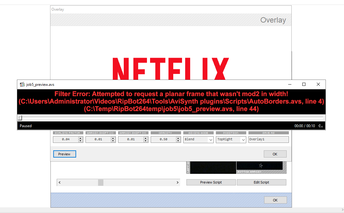

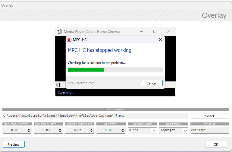

Originally Posted by Atak_Snajpera View Post
I did not expect that...
Dear Atak Snajpera
There're some errors caused by the overlay script in RipBot. Sample video is here (1080p): https://mega.nz/file/QkpGETzI#7ud8IB...NzGlgk1BgsfexI
A. Overlay's Scaling Factor Error (UNRESIZED)
The error appears, see this pic, only at certain values ​​as shown below, it's when the video is NOT RESIZED.
| 0.03 | 0.06 | 0.08 | 0.13 | 0.16 | 0.18 | 0.23 | 0.26 | 0.28 | 0.33 | 0.36 | 0.38 | 0.43 | 0.46 | 0.48 |
| 0.53 | 0.56 | 0.58 | 0.63 | 0.66 | 0.68 | 0.73 | 0.76 | 0.78 | 0.83 | 0.86 | 0.88 | 0.93 | 0.97 | 0.98 |
B. Overlay's Scaling Factor Error (RESIZED)
Another error appears, also only at certain values, as listed below, it only occurs in conditions when the video is RESIZED from 1080p to a lower, either by selecting one of the predefined resolution options (i.e. HD-Ready 1280x720), or by specifying the desired resolution (i.e. Custom [1.78:1]).
| 0.04 | 0.07 | 0.09 | 0.14 | 0.17 | 0.19 | 0.24 | 0.27 | 0.29 | 0.34 | 0.37 | 0.39 | 0.44 | 0.47 | 0.49 |
| 0.54 | 0.57 | 0.59 | 0.64 | 0.67 | 0.69 | 0.74 | 0.77 | 0.79 | 0.84 | 0.87 | 0.89 | 0.94 | 0.98 | 0.99 |
Furthermore, the error occurs in two different messages as follows:
  1. See this pic, it's when the downgrade is done via the options: HD-Ready 1280x720, PSP, iPHONE 480x270, and iPOD 320x240.
  2. See this pic, it's when the downgrade is done via the options: Custom [1,78:1] and Custom [x,xx:x].
Would you like to tell me how do I fix that?. Thank you, Atak.
