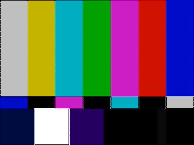

with intel igpu in 13th gen
ColorBars(width=640, height=480, pixel_type="yv12")
KNLMeansCL()
it's intel problem or KNLMeansCL?

real.finder is offline   Reply With Quote
I can't reproduce that here with an Arc A770, Ubuntu 24.10.
qyot27 is offline   Reply With Quote

Jamaika is offline   Reply With Quote
Old 1st December 2024, 16:25   #1572  |  Link
real.finder
Join Date: Jan 2012
Location: Mesopotamia
Posts: 2,641
maybe windows driver bug? like this https://forum.doom9.org/showthread.p...73#post1963373

the cpu plugins of NLMeans in avs can't be used as drop-in replacement for KNLMeansCL
BM3D is another story
Originally Posted by Z2697 View Post
that for vs only?
anyway thanks for CPU OpenCL runtime link, I thought Intel no longer supported that

no need to do it in this case
anyway, it worked with
KNLMeansCL(device_type="cpu")
after install w_opencl_runtime_p_2024.2.0.980.exe so it's gpu problem (maybe the driver)
KNLMeansCL()
Reproduced.
device_id = 0 (Nvidia driver)
no problems, this setting is using NVidia 1660 on my machine.
device_id = 1: (Intel driver)
artifacts.
This id is using my Intel UHD 750 driver. It looks like if there were internal format or endian-ness problems (e.g. how a 32 bit data is ordered YUVX or XVUY)
Hint: with
info=true
you can display the actual driver config.
KNLMeansCL(channels="auto", device_id=1, info=true)
My processor is 11th Gen Intel(R) Core(TM) i7-11700, but obviously, there must be a hidden driver setting which has to be checked to figure out that a pixel format which is good for one driver why is not good for the other.
