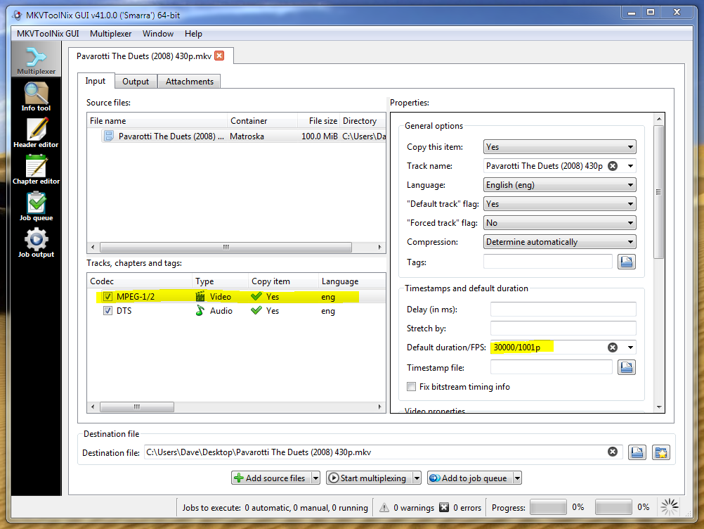

File has been badly muxed! FPS in container is 2x higher than FPS in video stream.
Solution. Remux mkv in MKVToolnix and specify correct fps for container.

My bad, I muxed the original VOB segments into a single file.
Remuxed to 29.97 fps (30000/1001), encoded with the restore->23.976 fps but ... unfortunately, it didn't remove the interlace.
