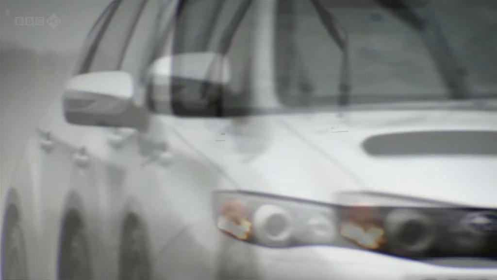

Doesnt like PAL MBAFF either (BBCHD)
ffms [info]: 1440x1080i 4:3 @ 27679/1001 fps (vfr) ??
Theres some weird effect playback too.
http://www.mediafire.com/imgbnc.php/...0fb0eedf6g.jpg
dansus is offline   Reply With Quote
Old 26th February 2011, 23:55   #172  |  Link
sneaker_ger
Join Date: Dec 2002
Posts: 5,565
Yes, I also had some troubles on your sample.
This command line seems to result in acceptable output:
x264 testhd.ts -o output.mkv --vf yadif:0,bff/select_every:2,0 --fps 60000/1001
I didn't manage to bob and I don't know what I'm doing wrong.
sneaker_ger is offline   Reply With Quote
