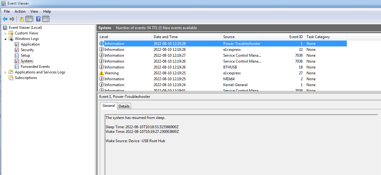

I suspect that some device is waking up your pc. Mouse, keyboard and so on... Windows should also have some logs showing what woke up your device.
https://www.minitool.com/news/find-w...-computer.html
wouldnt it stay on though if it was that?
the only thing apart from the lan, TV, AV reciever, UPS (via usb), is a logitech wireless keyboard.
ive monitored it tonight and it stays off for about 3 mins then powers up and before it even has time to send a post screen to my TV and beep it shutsdown. so maybe 5 secs?
ill trun off the keyboard and see if it stays off.

Like i said you should check logs in event viewer.
When in sleep mode poweroff your pc and then check logs
what command does ripbot use to put it into sleep mode? as server 2022 doesn't have sleep as an option when clicking the power button.

RipBot already puts your pc in sleep mode if you start encoding and you are outside the working hours. Just let it go to sleep mode and then power off after first loop.
Then open EVENT VIEWER an check this entry
ok found out it was the LAN adapter. changed to wake only on magic packet and disabled wake on pattern match and it worked.
next problem after going to sleep at 19:00 yesterday it didnt wake up this morning at 7:00. so tried WOL and it woke then shutdown. so pressed the power button and it woke from sleep. ripbot says its suspended till tomorrow at 7:00. so i tried changing my clock to 6:58 the next day and it goto 7:00 and nothing, that was while i was logged in not in sleep mode.
