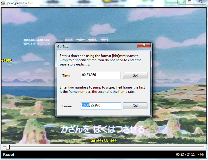

Old 5th June 2023, 10:15   #1965  |  Link
hello_hello
Posts: 4,829
Originally Posted by Atak_Snajpera View Post
Requested frame is not a correct frame. Returned frame is always requested frame+1
For as long as I can remember, seeking to a frame in a script has been off by one compared to seeking to a frame in the source video (at least for MKVs).
hello_hello is offline   Reply With Quote

as already said they just count different one starts a 1 and one at 0.
