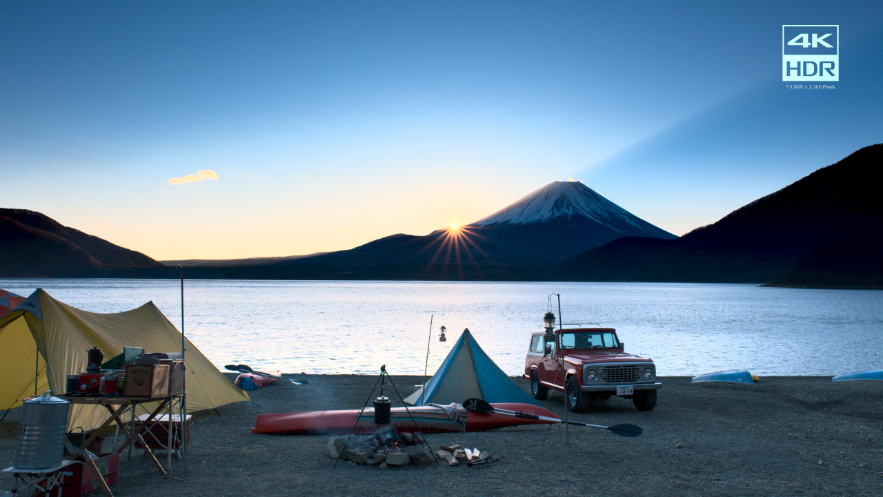

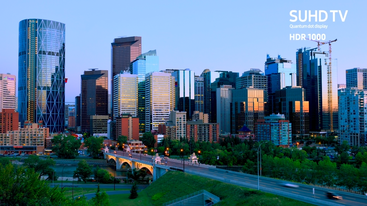

Has anybode managed to emulate madvr look using this plugin?
sample -> https://4kmedia.org/sony-camping-in-nature-4k-demo/
No matter which method I use I get either opaque white or oversaturated 4k logo
reference from madvr
BT2446 30000 (BTW. WhiteShift does nothing)
Reinhard exposure=12
Mobius exposure=15

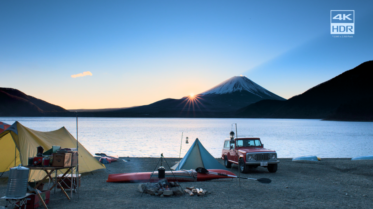

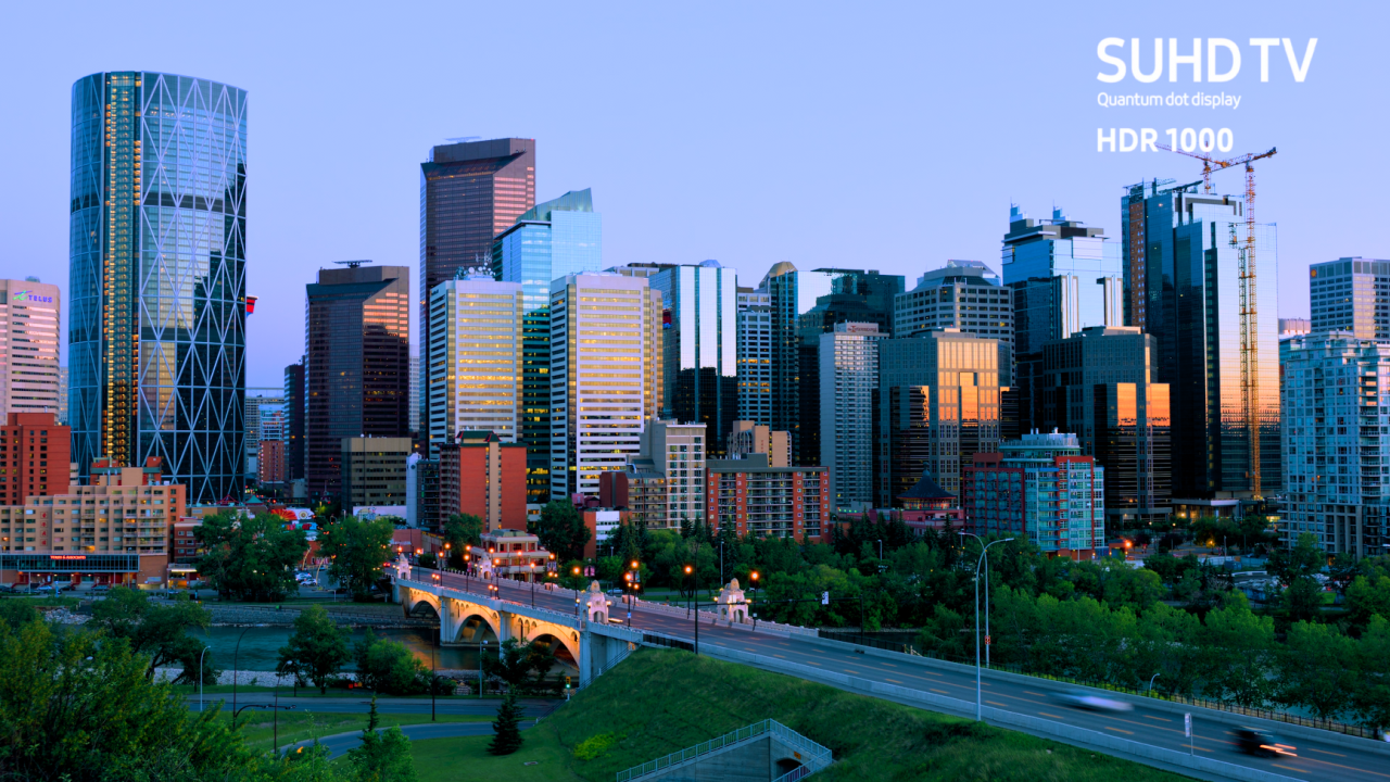

Ok. Mission accomplished! I've managed to emulate madvr tonemapping almost perfectly. Logo however is still slightly oversaturated. Sky gradient is also slightly different.
Emulated using Bt2446
video=ConvertYUVtoXYZ(video,Color=0,HDRMode=0,OOTF=false,OutputMode=2,Crosstalk=0.0,threads=1)
video=ConverXYZ_BT2446_C_HDRtoSDR(video,PQMode=true,Lhdr=50000.0,Lsdr=100.0,pColor=0,pct_ref=0.6,pct_ip=0.6,pct_wp=1.0,pct_sdr_skin=1.0,pct_hdr_skin=0.44,threads=1)
video=ConvertXYZtoYUV(video,Color=2,pColor=0,OOTF=false,Crosstalk=0.0,threads=1)
MadVR
I have also noticed that emulated method gives more realistic sky color than madvr's tonemapping
emulated
Madvr

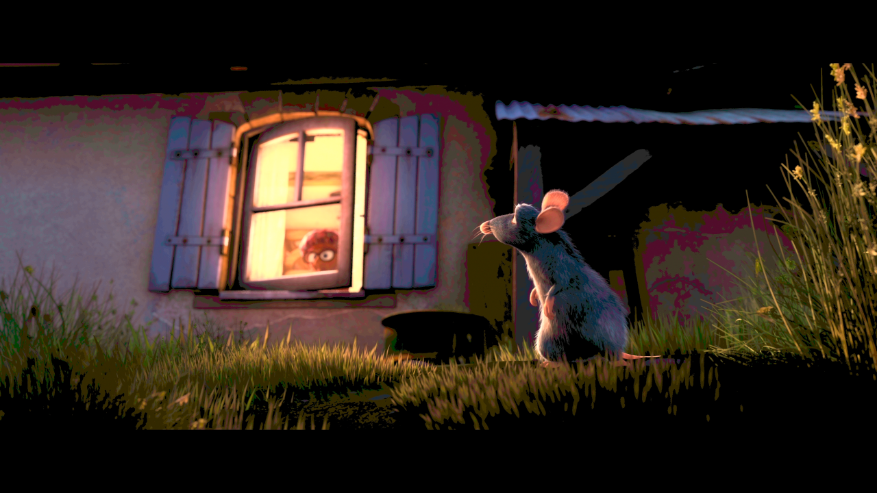

A little Test of Tonemapping from me. HDRTools is better then DGTonemap (both curves), the new ripbot x264 have good standard settings in the script. A few pictures from me, but i think DGHDRtoSDR is still the best tonemapper of Avisynth base (the best choice for me is Blackmagic DaVinci Resolve for tonemapping, via ACES). Also you con minimize the "Black Crush" Problems, if you set "fullrange=true" in the ConvertYUVtoXYZ Line.
madVR 100 Nits:
madVR 150 Nits:
madVR 200 Nits:
HDRTools Ripbot Settings:
HDRTools (QfG Settings ~100 Nits):
DGHDRtoSDR (QfG Setting ~100 Nits)
DGTonemap (Hable Curve Untouched ~ 100 Nits)
*The pictures are from a 4K HDR Upscale from me from Star Wars VII
** I Miss the spoiler function here
