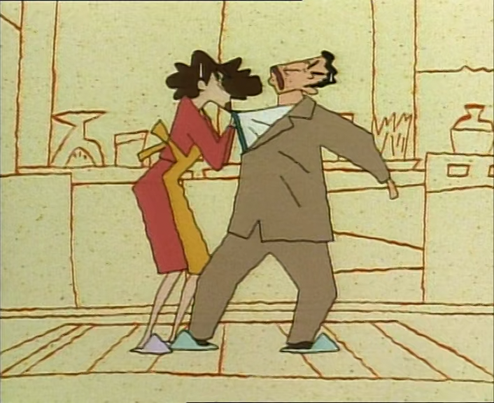

What about Cryon Shin 02?
Did all 31 files work for you?
byteshare is offline   Reply With Quote
Old 9th February 2019, 19:12   #16672  |  Link
Posts: 7,806
Because You use non standard DPI scaling. My app was designed for default 100%. BTW. scaling in win10 works differently than in win7. Win10 resamples content of the window and hence everything looks correctly. On other hand win7 only increased system UI elements like buttons and so on. Rest remains untouched and looks weird like you see.
Autocrop does not crop this black line because top/bottom line is not fully covered.
At least in that photo it should on the right side IMO.
To me if it is partial it should get cropped, probably why I always want the manual crop option in the batch mode...using notepad++ and doing a batch edit after the fact isn't perfect but much more work able than clicking through each job.
Next time I get the auto crop to not work correctly when it is a solid black line I'll send you some samples again.
