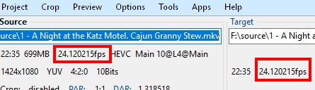

Atlantis
Join Date: Feb 2002
Posts: 758
Originally Posted by Patman View Post
I've updated my builds and add two versions of x265. The one from git (x265-3.2...) and the modifided version (x265_custom_...) with custom progress bar like MeteorRain uses. THX for code @ MeteorRain
What are those? Can we see screenshots?
Just cosmetic
Screen Comparison
Tools for StaxRip | x264 - x265
