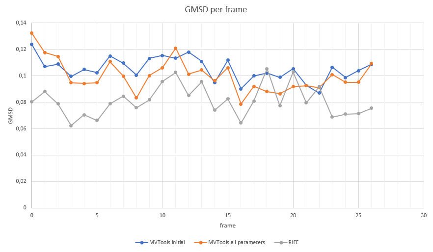

I have some results to report. But first, let's go briefly over the setup. I decided to use the AviSynth version of MVTools2 as I think it might be the definitive version, created by master pinterf himself and thorougly tested by myself. So I will not include the script I used with Zopti here, but I can link to it if anyone is interested. The script uses MFlowFPS & Co to create intermediate frames that in the end can be compared to the original frames of the source. The basic idea is: (I may not have the charting skills of Mark but I can try... )
 0         1         2         3	time (frames)
[A ]      [B ]      [C ]      [D ]	original frames
[A ] [AB] [B ] [BC] [C ] [CD] [D ]	1) interpolate new frames (MFlowFPS)
     [AB]      [BC]      [CD]  		2) remove original frames (SelectOdd)
     [AB] [BB] [BC] [CC] [CD]		3) interpolate new frames again (MFlowFPS)
          [BB]      [CC]    		4) leave only latest interpolated frames (SelectOdd)
[B ]    [C ]				5) compare original and interpolated frames (GMSD)
[BB]    [CC]
I focused on the difficult part of the scene (the guy moving in front of background) so I cropped it and selected a smaller frame range. If this part is OK, the rest of the frame will be too.
I wanted to get something running quickly so I used an old template I had which doesn't have all the parameters of MAnalyse. Notably levels, pzero, pglobal, dct and scaleCSAD are missing. I will add those in the coming runs. I used the GMSD metric as I know from experience that it's more sensitive than SSIM. MDSI might be good also but GMSD is a bit more convenient to use as it doesn't need RGB clips.

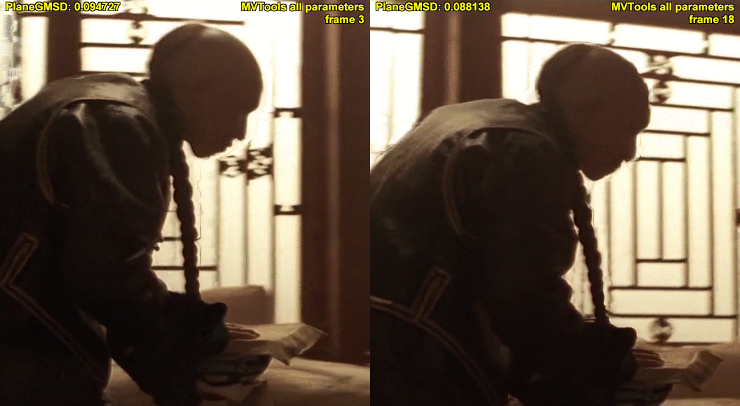

Best result is now 2.843625. The second run got almost as good result but the third one was much further behind. This just shows that good results are not guaranteed even with this many iterations. The results now also agree on blksize, overlap, overlapv and divide. Also search, searchParam and temporal equal on the best two results. It could also be a fluke as we only have three runs to compare. There are also other values in close proximity within runs 1 and 2: lambda, pnew and badrange.

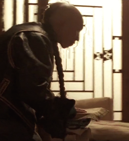

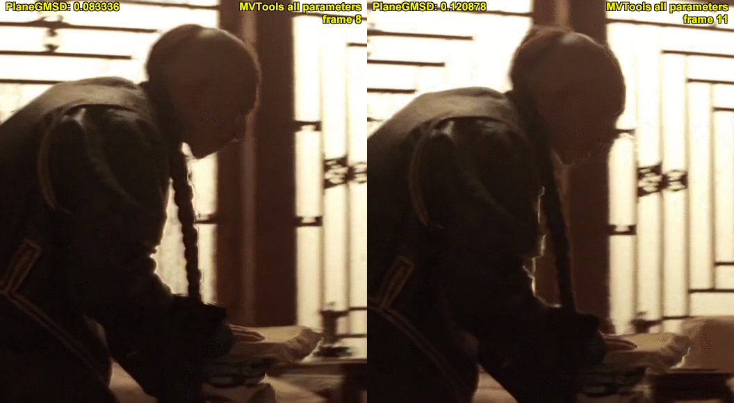

This is what the best result (so far) looks like (note that this is only showing the interpolated frames)
As you can see it cannot compete with RIFE but at least it's better than the plain jm_fps result (I assume that's what was used) poisondeathray showed. Also it's clear to me that it's not even possible to get a nice foreground/background separation by swizzling 16x16 blocks around. This clearly needs MRecalculate to use smaller blocks.

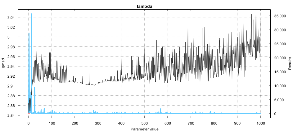

  lambda			7 		6 		3

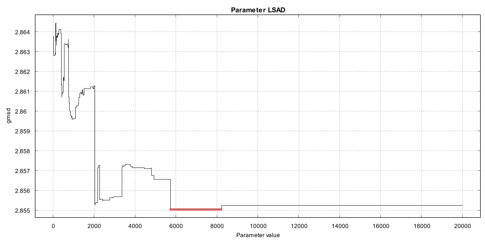

  lsad				18930		932		2084

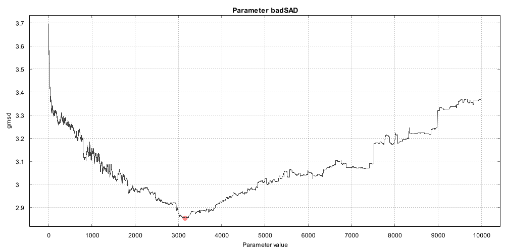

  badSAD			3234		3167		3170
  badrange			13		12		12

So unfortunately 8x8 was not better than 16x16, the best 8x8 result 2.8553133 did not beat the champion 16x16 result 2.843625.

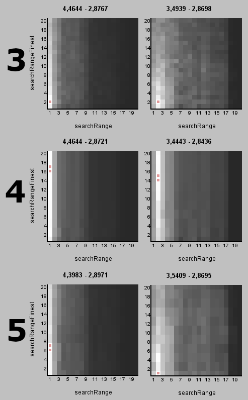

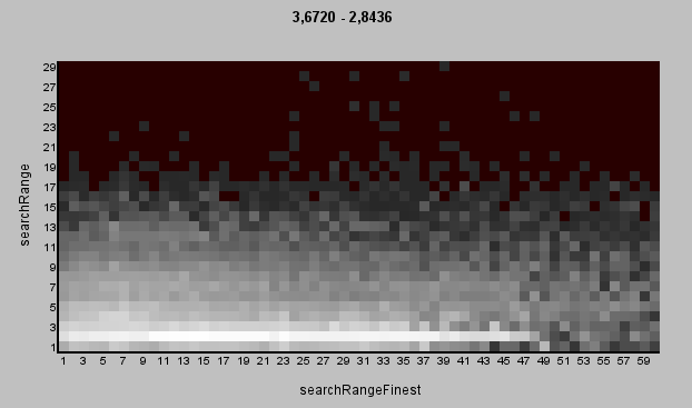

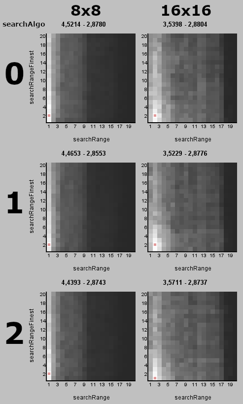

I was a bit puzzled as to why the optimal searchparam value (which controls the search radius) is very low, just 1 in the 8x8 case and 2 for the 16x16 case. I would have expected that larger radius cannot hurt the results but it looks like it can, and a lot!
I did some exhaustive searches around the optimal values just changing searchparam and pelsearch and drew some heat maps for each search algorithm. Results below (note that searchparam is named searchRange and pelsearch is named searchRangeFinest, it controls the search radius at the finest level):
The brighter the color, the better the GMSD score. The best value is highlighted by a red dot (or dots if there are multiple best results). The decimal numbers above the maps are the worst and the best found GMSD score.
This confirms that there is no better alternative to these low search radiuses. This is my guess as to why larger radius doesn't work very well here: The background has a very repetitive pattern and that means there can be very good SAD scores at far away locations. So with a large search range some blocks will get best score at those far away locations and some will find the closest "correct" location and the mixing up of these far/close vectors looks ugly. The following gif demonstates what it looks like with search ranges 2 (optimal), 4 and 8:

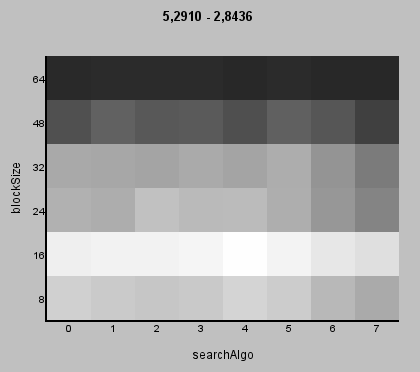

Another mystery is that the search algorithm 3 (exhaustive search) was not the best one in either 8x8 or 16x16 case. The docs state that "It is slow, but it gives the best results, SAD-wise". Perhaps there are other factors involved and the best SAD is not all that matters.
Algorithm 4 (hexagon search) is a curious case, the pelsearch parameter has very little effect on the result and the best result is at pelsearch 14-17 while with other algorithms it is at around 2 (algorithm 5 is an exception as well). I guess this explains why it was found quite often as the best algorithm.
It's also easy to see that with 16x16 blocks it's overall easier to find good results, there is a steep drop to bad results with searchRange > 9 with 8x8 blocks while that dropoff happens at searchRange > 17 with 16x16 blocks. Also the bad results with 8x8 blocks are much worse (around 4,4) than with 16x16 blocks (around 3,5).
I have more results to share but that's enough for now.

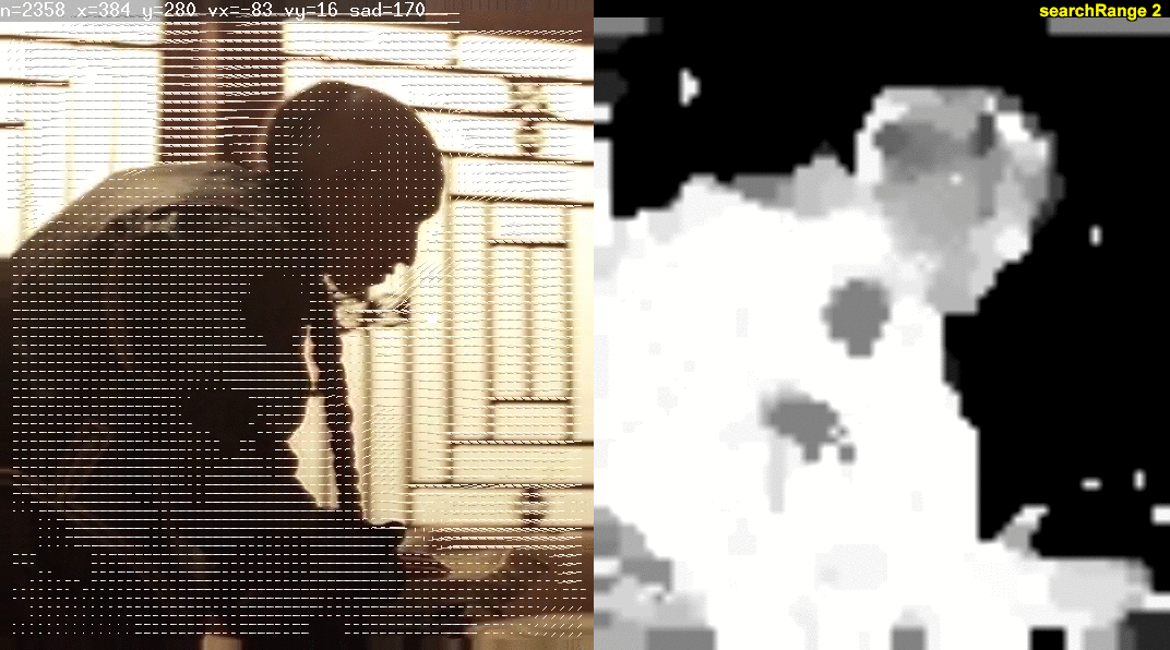

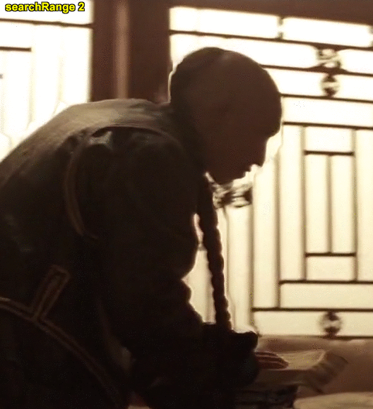

Some further analysis about the search range: looking at the vectors shows what is actually going on:
These are the backward vectors of a single frame with search range 2 (good) and search range 8 (bad). On the left are the vectors drawn with MShow and details on one single block. On the right is the horizontal vector direction displayed as brightness using MMask.
What happens with search range 8 is that some vectors switch to opposite direction (the vx changes from -83 to 64). The same however doesn't happen on the forward vectors. MFlowFPS then has to deal with two conflicting vector directions and the end result is that some pixels are not moving anywhere (or very little) while those around them are.
Usually this kind of problem is avoided by making the vectors more coherent using truemotion=true or setting lambda, lsad, pnew, plevel and global individually. Perhaps Zopti used a shortcut here and avoided the problem by using a very focused search range. It would be interesting to force a larger search range and let Zopti figure out good values for the aforementioned parameters. Or perhaps it's simply not possible to achieve as good of a GMSD score using a larger search range because more coherent vectors make object boundaries harder to follow.
EDIT: The default search range of MVTools2 is 2 so what is used here is actually very normal. A larger search range would only be useful with faster motion.

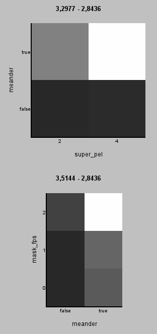

Meander=false results in much worse results, somewehere around 3.29. Meander is "Alternate blocks scan in rows from left to right and from right to left." and defaults to true. I'm not quite sure why this has such a large effect on the quality, but since it has we can simply "lock" this parameter to true.
Pel is another parameter where value 4 gives clearly better results than 2 (and I didn't even test 1) at least on this particular test case. Pel controls the precision of the motion vectors so it's quite understandable that a larger precision helps. It's not necessarily always the case though but it's safe to lock the value to 4 for these tests.
Ml (mask_fps in the heatmap) with value 2 seems to give much better results than 0 or 1. Ml affects the strength of occlusion mask, the lower the value the stronger the occlusion. Looks like occlusion mask is not helping in our tests so we lock the value as 2.

Looks like blockSize 16 is much better than any other. I still wouldn't lock it down but we can at least remove the block sizes 32 and above, leaving just 8,16 and 24. I'm also adding new block sizes 3,4 and 6 (those didn't exists when I originally made the zopti script). This also means the maximum values for overlap and overlapv are now 12 (half of 24).
Search algorithms 6 and 7 are not quite as good as the others. Algorithm 6 is "pure horizontal exhaustive search" and 7 is "pure vertical exhaustive search" which explains why. We can leave them out from the next tests.
Next we'll look at the search ranges (searchparam and pelsearch). The heatmap shows only the top 50% of results so we can see them better.
The original search range was 1..30 for the search range and 1..60 for the finest level. The optimal values were 2-4 and 6-14 respectively. The best value of 2 for searchparam is clearly visible, for pelsearch many values give almost as good result as the best value of 14. Let's limit the search range to 1..8 and the finest level to 1..30.
I did an exhaustive scan of parameter LSAD to see how changing just that one parameter will change the result. The other parameters were using the best values found for 8x8 block size.
The red portion of the line is the best result and looks like many values give the exact same result. There are other sections where changing LSAD doesn't change the result at all. Looks like it doesn't pay to try every possible LSAD value, we can add a filter to only test values divisible by 100. Also the results are not changing at all after a bit over 8000 so the search range can be limited to max 10000. It's also worth mentioning that the effect of LSAD is very small, even the worst possible LSAD drops the result to 2.864 from 2.855.
What about badSAD?
The effect of badSAD is much stronger, choose it badly and the result drops to 3.7. BadSAD doesn't have flat areas but at least we can set the maximum to 8000.
Lastly we look at lambda. I used lambda range 0..20000 in the first tests but the best lambdas were very small, just 12 in the best found result. We'll limit lambda range to 0..200. Below the best result per lambda value (the blue line shows the number of tests per lambda value). Note that this chart was not from an exhaustive search but just shows the best found result from the original search runs, that's why the line jumps so wildly.
One more change is that we allow negative values for parameter badRange which is the range of wide search for bad blocks. The negative sign indicates that the algorithm is switched to exhaustive search.

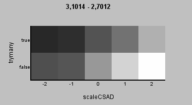

  • trymany=false is surprising, or perhaps I don't understand what it means. The docs say "try to start searches around many predictors". So it sounds like trymany is doing more work to try to find the best possible block matches but somehow this ruins quality. Perhaps it's the same phenomenon we saw with the large search range (which also destroys quality).
  • scaleCSAD=2 means the luma:chroma ratio used in SAD calculations is 4:8 so chroma is twice as important as luma. That's a bit of a suprise. In my script the video is converted to YV24 before going into MVTools so chroma already has the same resolution as luma.
ScaleCSAD and trymany can be seen below as a heatmap. The larger the weight of chroma the better the result. And trymany=true consistently results in worse score.
So how much better is 2.6988451 than 2.843625? What do these values even mean? The script calculates the total GMSD score. There are 27 measured frames so the average per frame is almost precisely 0.01. It's also important to remember that we're measuring the quality after two interpolations while the frame-doubling only needs one so the quality in practical use is perhaps twice better, about 0.005 per frame.
I wanted to see how the optimized script compares to RIFE so I did a similar double-interpolation using RIFE ncnn Vulkan with the latest v3.1 model and measured the GMSD. RIFE's total was 2.192934 (NOTE: RIFE works with images and round-trip YV24->png->YV24 gives GMSD penalty of 0.336003). The chart below shows the per frame GMSD scores for the initial version, the latest version with all the parameters and RIFE.
On some frames MVTools actually pulls ahead but RIFE is still better overall. Also notable that the latest MVTools script is actually worse than before on some frames and two worst single frame GMSD scores are from this latest version. We could of course optimize for minimizing the largest per frame GMSD and get different results.
Let's compare some frames where the latest script did better (frame 8) and one where it did worse (frame 11). These are the doubly-interpolated frames.
And here's a comparison of the latest MVTools script and RIFE. Frame 3 shows where RIFE is much better and frame 18 shows where MVTools beats RIFE.
Here's the complete MVTools result with score 2.6988451, again only showing the interpolated frames.
