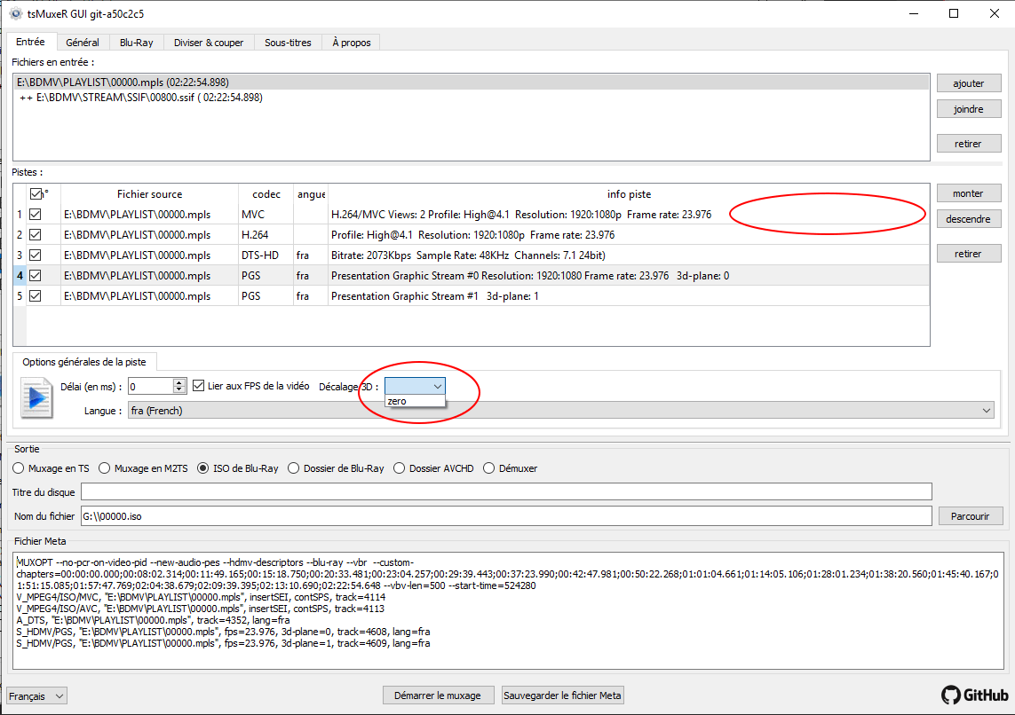

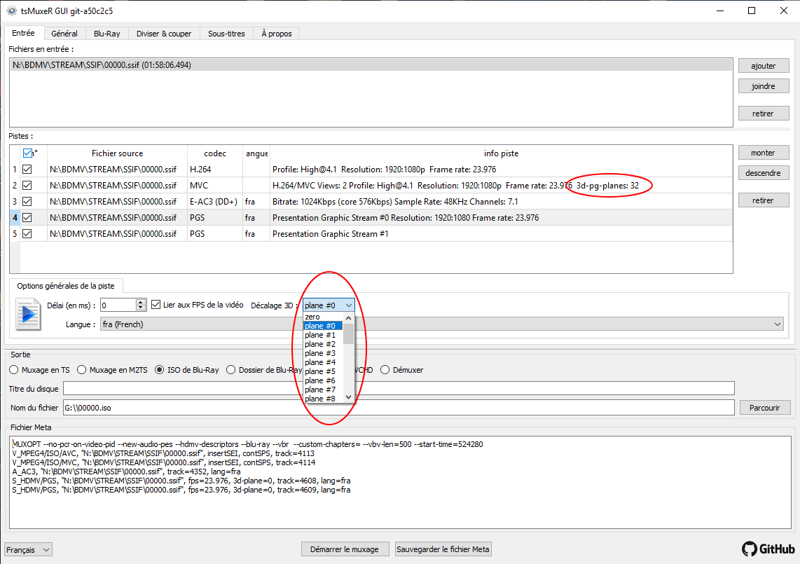

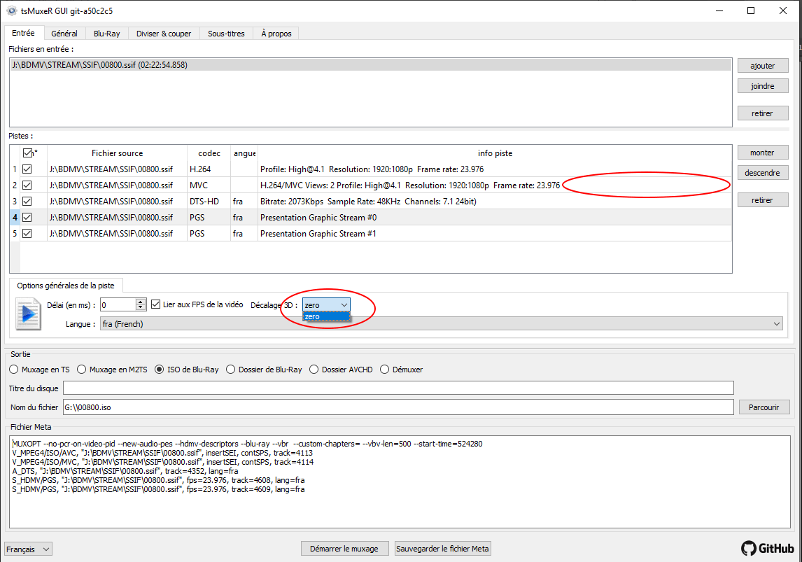

PGS subtitle problem in 2D (iso 3D AVC MVC).
Reading the .mpls file we see that there is a problem with the MVC track, it is missing "3d-pg-planes: 32", the subtitles not the "plane #" option ...
Same in the .ssif
A normal 3D blu-ray
Is there a solution ?

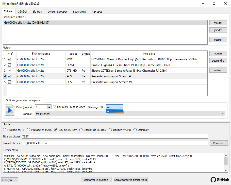

Originally Posted by a5180007 View Post
@vanden same, please give a link.
Thanks, splitter in .m2ts but it is sufficient to test : http://vandenk.free.fr/00000.split.1.m2ts
vanden is offline   Reply With Quote

Thanks @vanden, I have the file.
The number of offset sequences is extracted from the metadata info stored in the clpi and the m2ts.
Each offset sequence includes the direction flag and the offset value of the subtitle.
If there is no metadata in the clps or the number of offset sequences in the metadata is zero, then you cannot select any other value than "zero" in tsMuxer as there is no offset data available.

There is no way to create the metadata ?
Old 21st May 2021, 21:28   #1075  |  Link
a5180007
Join Date: Jun 2014
Location: Marrakech, Morocco
Posts: 253
@vanden definitely not with tsMuxer. Maybe with a professional authoring software.
a5180007 is offline   Reply With Quote
