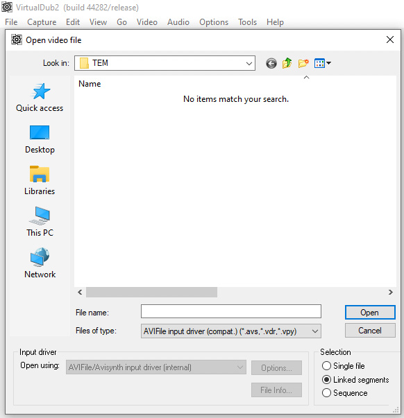

Maybe like so, [Set, "Files Of Type"] [EDIT: Untested, I dont use vpy]
How do I use Caching Input Driver for my scripts, then?
