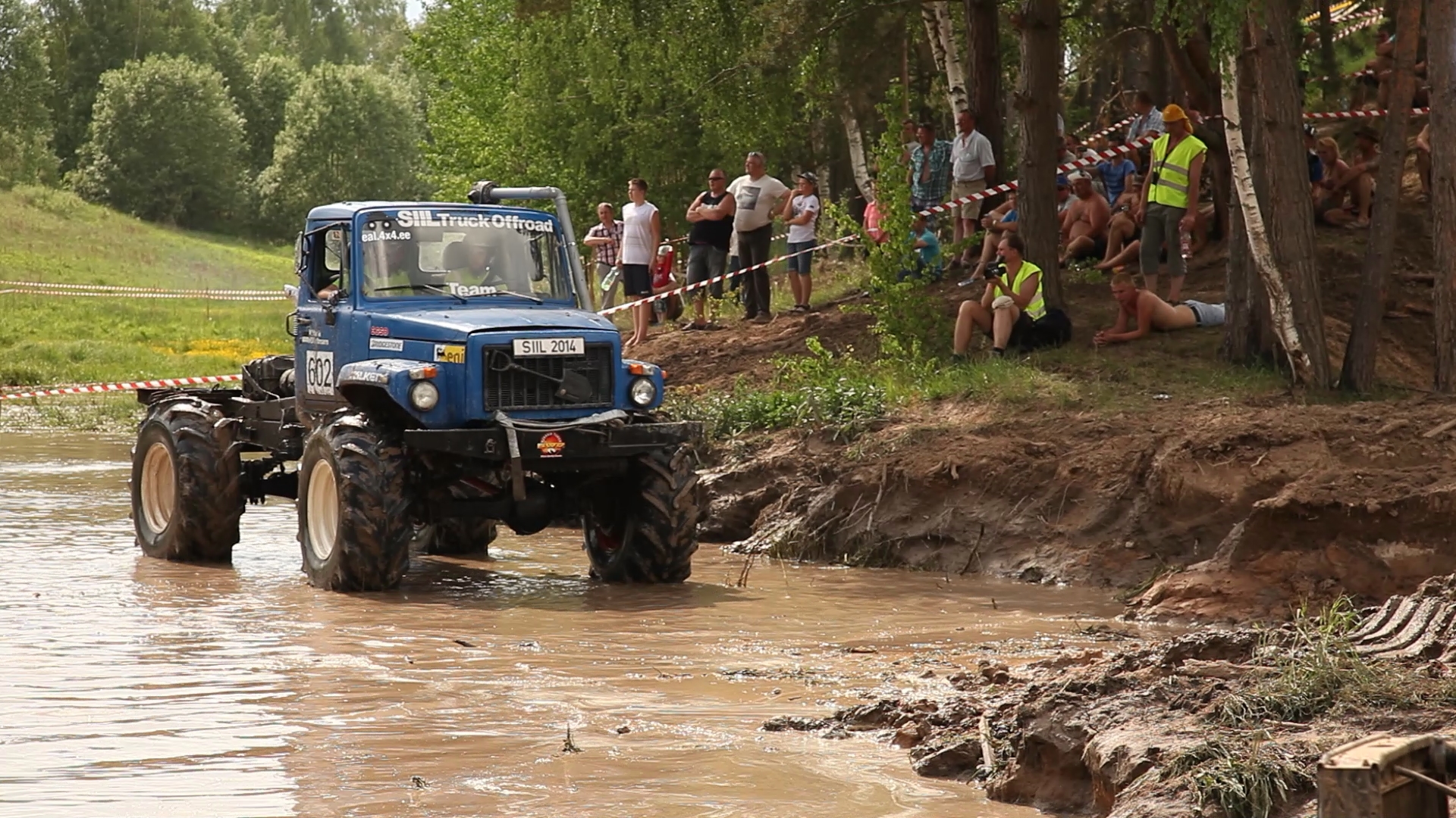

but i even found better examples - basically all green, skin and water areas get even more degraded than i noticed before:
https://www.upload.ee/image/9804427/MOV_snapshot1.jpg
https://www.upload.ee/image/9804363/x265_snapshot2.jpg
(it was even noticeable when i saved the MOV image with 95% quality and x265 100%)
original video file is 2:38 and 895MB, hevc 10bit is 201MB(without fast decode and with 22rf)

Yes HEVC should be fine for those use cases.
Regarding the green degredation, this is indeed just softening due to compression. Lower crf (aka raise bitrate) and possibly disable SAO as well.

i just enter --no-sao into the extra options for that? if that should work, then it actually made things even worse... so now i just try with 20rf and the sao thing default...

SAO is a very powerful tool, but for absolute max quality it's often better to disable it to improve sharpness. Sound like you need to raise bitrate more.
