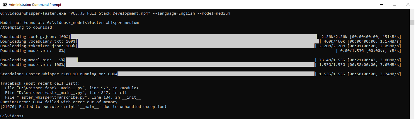

I got an error which, I assume, is due to the fact that my input is a 4 hour long video, or maybe I have too many windows open, or both.
No, that's irrelevant.
From the screenshot you can see that it's out of the video memory.
How much of VRAM there is in your GPU, and what is the model of your GPU?
